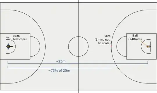

Let's assume the top photo was taken when Earth-Mercury-Sun is a straight line (this will be very close to true in the top photo). Let's set up the same scenario on Earth, but scaled down.
The diameter of Mercury is 4900km, the Sun is 1.4 million km. This is a ratio of 285:1. Mercury is 40 million km from the Sun, Earth is 150 million km (ignoring eccentricity, etc). Mercury is about 73% of the way to the Sun from here.
A basket ball is about 240mm in diameter. Something 285 times smaller than that is just under one millimetre. That's about the size of a spider mite or a large grain of sand.
In order for the ball to occupy 0.5 degrees of your vision, it needs to be 25 metres away. That's the length of a basketball court, which are probably not in use right now, so lets go down to one. Place the ball under one hoop, then put the spider mite on the tip of the "three point line" at that end of the court. It's magical, so it floats 120mm from the ground. Handily, one hoop's three point line is almost exactly 73% of the way to that hoop from the one at the far end. Now go and lie down under the other hoop and position your head so the mite is in front of the ball from your perspective.
When you look at the tiny mite out there on the far side of the centre line, and the ball at the far end, you have pretty much the same scenario as Earth:Mercury:Sun during a conjunction. Notably, you probably need a telescope to see the mite at all under any kind of normal lighting. Looking at the mite "transiting" the ball though your telescope, doesn't the magnified ball look enormous with the mite floating in front of it like a speck?
Now, go back to the mite and look at the ball from its perspective (don't stand on the poor thing). The ball doesn't look hugely bigger from here, does it? You can probably read more of the writing on it and see the texture, but it's still not taking up all of your vision.
This is because you're not using your telescope any more. If you use the same telescope you used to look at the mite and ball, but stand almost 4 times closer than you were originally, the ball will look even huger.
If you wanted the Sun to look the same size as a basketball does when holding it with the surface 0.5m from your head (2 diameters), that's about 3.5 million km orbital diameter: much, much closer than Mercury really is.

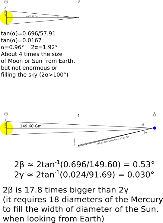

The size of the object (i.e. Sun) on the Sky doesn't depend on how big is the body you are sitting on (i.e. Mercury). It only depends on a distance from you to this object and its size.
So the size of the Sun when viewed from Mercury depends on the distance from Mercury to the Sun, and size of the Sun.
Similarly when viewing Mercury and Sun from some distance (i.e. from Earth), it purely depends how far you are from the Sun and Mercury, and how big they are (constant).
In fact if you are just few meters above the ground of Mercury, it is bigger than the Sun in your field of view. Way bigger.
If you are very far away (like orbit of the Earth), the apparent sizes ratio between two observed bodies is the same as ratio of their diameters. But that is not the case when you are closer.
Attaching a sketch of calculations, that should help you see it better.
