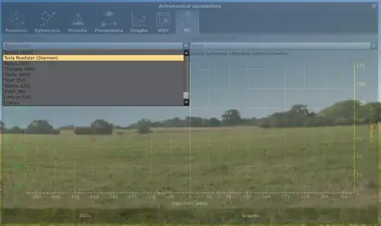

If you specificaly want to know the distance between planetary bodies, you can use the astronomical calculations tool in Stellarium. To access the tool, either press F10, or go to the left hand side toolbar pictured below
From there, go to the "PC" (for "Planetary Calculations") page
Here, you can select any two bodies in the Solar System (including the Tesla Roadster!)
And you can either show the distance at a given moment along with a few other bits of data, or plot the distance between the two over time.
Since, you can also move in time in Stellarium (using the J, K and L keys, or with the buttons in the bottom toolbar, or in the Date/time window with the F5 key), you can set the time and date to any moment, and see the distance between bodies of the Solar System at that moment.
