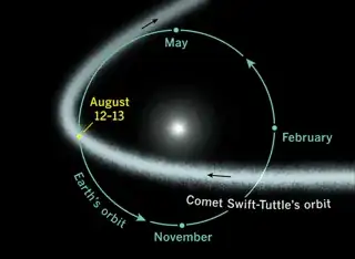

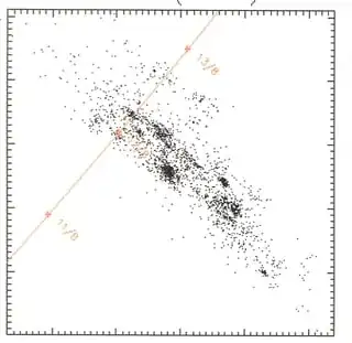

Left: From What (actually) is Jupiter doing to this year's Perseids meteor shower? Right: From Why would the Perseids meteor rate fall off after maximum faster than the increase before maximum? - click each for full size
