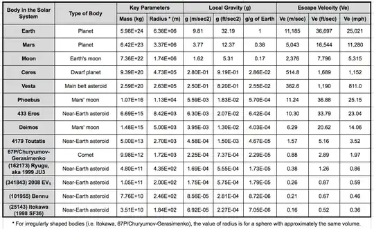

Assuming an object with the same density as earth (not very good approximation) then a spherical object with a radius of 2.5 km, would have an escape velocity of about 96 mph. A velocity reached by several MLB pitchers. There are probably several asteroids with a radius near this.

but you can choose about half that density to make this even more useful! See Are there any known asteroids with average density similar to that of Earth's? and this table – uhoh Feb 22 '20 at 00:34
I don't think this is complete - there may be objects between Phobos and Vesta. Phobos and Vesta have too little mass to be rounded under their own gravity, so the escape velocity may depend on where you are standing.

"I don't think this is complete - there may be objects between Phobos and Vesta" is a bit of an understatement! This is a hard question to answer; unless someone happens to know where to find complete tables with estimated masses and sizes it will require a lot of work to hunt those down. However such a big hole between 25 and 800 MPH I don't think this addresses the OP's question "What is the largest known body in the solar system..." very well. – uhoh Feb 21 '20 at 02:23
1@uhoh List of Solar System objects by size, but there are large uncertainties for the masses. – Keith McClary Feb 21 '20 at 03:10
