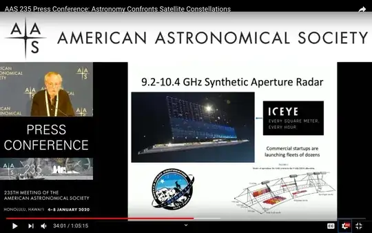

After about 34:00 in the 9th press conference of AAS 235, radio astronomer and NRAO's spectrum manager Harvey Liszt talks about Radio Astronomy in a New Era of Radio Communication and says:
This is a new development that we’re going to have to come to grips with. There is a band allocated between 9.2 and 10.4 GHz (this is roughly an order of magnitude lower than you saw for CloutSat) and these are being developed commercially now, and if you look on the right you’ll see ICEYE. ICEYE’s slogan is “Every square meter, Every hour”.
A synthetic aperture radar like this, if pointed at a radio telescope when the telescope is pointed in its direction will burn out the radio astronomy receiver.
As a matter of fact, some of these radars are so strong that even the ground scatter (the albedo of the ground is about 10%) and even the backscatter from radar will burn out a radio astronomy receiver.

At the recent American Astronomical Society meeting in Hawaii, Dr Harvey Liszt from the US National Radio Astronomy Observatory raised the concern that powerful radar pulses from orbit could damage the radio receivers that scientists employ in their ground observatories.

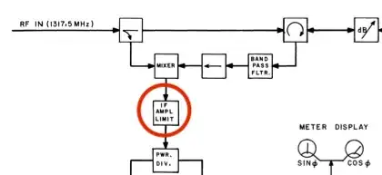

Receiver Limiting
To prevent receiver damage from excessive input signals, particularly in-band, where filtering would be ineffective, an RF power limiter may be employed. One type of limiter, the PIN limiter diode, as described in PIN Limiter Diodes in Receiver Protectors:
The PIN limiter diode can be described as an incident power- controlled, variable resistor. In the case when no large input signal is present, the impedance of the limiter diode is at its maximum, thereby producing minimum insertion loss, typically less than 0.5 dB. The presence of a large input signal temporarily forces the impedance of the diode to a much lower value, producing an impedance mismatch which reflects the majority of the input signal power back towards its source.
For those interested, a receiver architecture incorporating such listing can be found in Electronics Division Internal Report No, 113 3-Element Interferometer 3,7, 11, and 21 cm Receivers. This document describes one of the receivers used at the National Radio Astronomy Observatory at Green Bank, West Virginia. I have reproduced part of one of the block diagrams below highlighting the receiver limiting.
