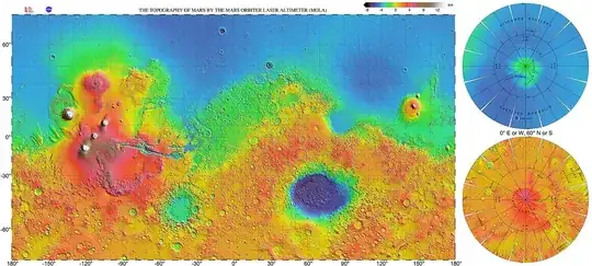

Looking at Mars map: enter image description here
the highest, biggest mountains and their associated highlands are essentially antipodes of the deepest, huge basin. Roughly 180 degrees away, similar latitude except opposite sides of equator... this immediately brings to mind the idea that an asteroid impacted the area of Hellas Basin, and the shockwave traveled clear across the planet causing a bulge of Tharsis Rise, and causing multiple volcanoes to sprout there.
Is there anything to this impression, or am I entirely wrong?
SF.

You were not the first to have seen that the Hellas Basin and parts of the Tharsis Rise are roughly antipodal (Peterson 1978, Williams and Greeley 1994). The Tharsis Montes themselves are far too close to the equator to be considered antipodal to the Hellas Basin. The shield volcano Alba Mons however is almost exactly antipodal to the Hellas Basin.
This shield volcano is a bit to the north of the Tharsis Rise proper, and well to the north of the Tharsis Montes. Both Peterson and Williams suggested that the Hellas Basin impact might well have triggered the vulcanism that resulted in Alba Mons.
There's an issue with this hypothesis, which is that the apparent ages do not align. Improved remote observations of Mars has provided a tool for estimating ages of Mars features: crater density. Based on crater density, the Hellas Basin appears to be very old, at least 3.8 billion years old (Carr 2010). Alba Mons, while also quite old, isn't that old. It formed at least 200 million years after the Hellas Basin impact and perhaps as much as a billion years after (Ivanov 2006).
Bottom line: If the huge impact that formed the Hellas Basin did have any antipodal effects, those effects are buried under the magma that formed Alba Mons several hundred million years later.

  • The two don't need to be exactly antipodal - depending on angle of impact. – SF. Jan 17 '20 at 12:43
    @SF. - The hypothesis that large impacts can have antipodal effects is based on the observation that the sound waves that result from large impacts will meet themselves more or less at the antipode of the impact point. The angle of impact has nothing to do with the speeds at which sound travels through rock; that is purely a function of the rock itself. – David Hammen Jan 17 '20 at 13:10
    @SF. - There are other bodies in the solar system that might be candidates for this antipodal impact effect hypothesis. Mercury and Vesta for example both have large impact craters with heavily fractured landscape at the impact craters' antipodes. But not Mars; the Tharsis Rise is considerably younger than is the very old Hellas Basin. – David Hammen Jan 17 '20 at 13:18
