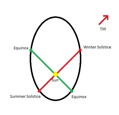

Equinoxes and solstices are determined by the direction of tilt of the planet's daily rotation. The direction of tilt of a planet's rotational axis is essentially random, (mostly) constant, and unrelated to any property of its orbit.
I did not calculate the precise correct position of the sun in the below diagram, but it doesn't need to be precise to illustrate the point. The planet's tilt is toward the upper right of the diagram at all points in the orbit, changing only very slowly in a process called precession that takes many millennia.
Diagram of equinoxes and solstices on an orbit

    Nice diagram. Just to make it clear that there's no preferred direction or no preferred hemisphere, "Tilt" could have arrows in both directions and "Summer Solstice" and "Winter Solstice" could just be "Solstice"s. – Eric Duminil Jan 13 '20 at 14:23
