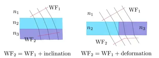

Let's visualize the basic idea behind the seeing. Suppose to have a light source located at infinite distance, such that it's ideally a point source and its light reaches Earth in plane waves. When entering the atmosphere these waves face changes in the refractive index, and in geometrical optics approximation the wavefronts are deformed according to Snell's law. In the following image you have two simplified cases: on the left, it is shown that a vertical gradient in the refractive index produces a simple tilt of the wavefront; on the right, it is shown that a horizontal gradient produces a deformation of the wavefront. Here $\textrm{WF}_1$ is the incoming unperturbed wavefront, $\textrm{WF}_2$ is the same wavefront after entering the atmosphere and $n_i$ are the refractive indices.
$\hskip2in$ Simple picture

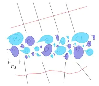

Let's now approach the real case. It is known that variations in the refractive index are related to variations in density (e.g. via Gladstone-Dale relation). Since our atmosphere has an overall more-or-less stationary distribution of temperatures, densities, and pressures, the most dramatic variations of the refractive index are found only in the turbulent layers. Here each turbulent eddy can have different density, temperature and so on, causing local variations in the refractive index. These layers are located in the first km of atmosphere (the planetary boundary layer) and at $\sim$10 km (near the tropopause). In the following image, it's depicted how a plane wavefront is deformed after crossing a turbulent layer and all of its eddies with different $n_i$. The lenght $r_0$ is the Fried parameter, which can be interpreted as the characteristic lenght of the turbulent eddies.
$\hskip2in$ More realistic picture
What is atmospheric scintillation then? Well, as you see from the previous image, the curvature of the wavefront leads to a convergence (or a divergence) of the light rays (i.e. the lines perpendicular to the wavefront). This means that when you take an image by collecting photons with your sensor (i.e. when you collect a portion of the wavefront) the image brightness can rise or decrease depending on whether light rays are converging or diverging. Furthermore, this brightness variation is time-dependent, since the eddies evolve with time and the turbulent layer has an horizontal drift velocity. This is scintillation.
To see scintillation you need that (i) the source has small angular dimension, (ii) the turbulent layer is far from the telescope, (iii) the characteristic length of the collected wavefront's portion (e.g. the diameter of the telescope) is comparable to $r_0$, (iv) the exposure time is less than the lifetime of the deformation. If (i) and (ii) are not satisfied you might see the motion of the source instead of scintillation, while if (iii) and (iv) are not satisfied you will see speckles or a smeared image.
