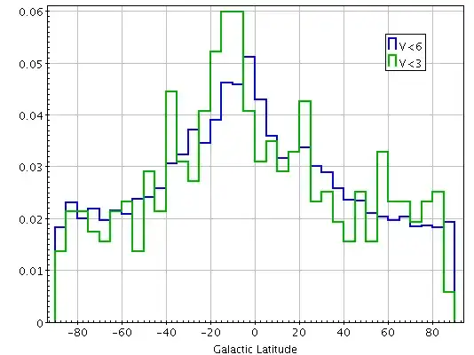

I did an analysis of this in https://astronomy.stackexchange.com/a/10260/2531 , but the important plot is repeated below. It shows the normalised density of stars (per square degree) as a function of Galactic latitude. (Note that I have correctly handled the changing area of the latitude strips). You can see the peak at low Galactic latitude and even work out that our viewing point is probably slightly above the Galactic plane, given that the peak is at about $-10^{\circ}$. The peak is still there in 3rd magnitude stars. You could repeat for a sample limited to even brighter stars, but you run into number statistics trouble.
The distribution of bright stars with Galactic latitude. The y-axis is the normalised number of stars per square degree. i.e. The integral sums to 1.
Galactic latitude distribution of bright stars

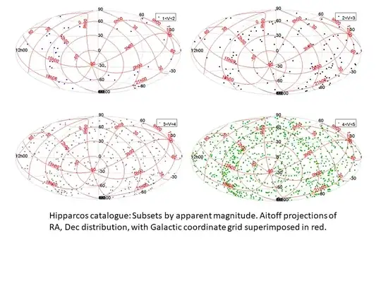

Below I show the Hipparcos data, divided into 4 apparent magnitude bins. Points are plotted on a RA vs Dec Aitoff projection. Superimposed in red is a Galactic coordinate grid. There are too few stars with $V<2$ to form much of an opinion, but for fainter stars, a ring-like structure, coincident with the Galactic coordinates equator (i.e. Galactic latitude of zero, or just below, as I showed in the 1D projection above) is clearly seen.
Spatial distribution of stars on an Aitoff RA, Dec projection, with Galactic coordinate grid in red

  • I read the linked answer too, and it's not what I want. You're plotting by galactic latitude. I want to plot by position of the star, so RA and DEC. One cheap way to do this, just by "eyballing" it, is to find a star map that only shows stars of mag 1 to 2, then a map that only shows stars of 2 to 3, etc. Then you could just look at the map and see if it looks uniform, of if there is more density somewhere. I searched but cudnt find those, but i could make one myself. But I'm not sure if I can do a true statistical analysis to say if its uniform or normal or something else. I will try tho. – DrZ214 Dec 16 '19 at 20:17
    @DrZ214 you asked whether it is (spatially) uniform. The answer is that it isn't. I fail to see how that does not answer the question you actually asked. I plotted by Galactic latitude because that is what the density depends on. There is no clear dependence on Galactic longitude and no reason at all why there should be a direct dependence on RA and Dec. – ProfRob Dec 16 '19 at 21:06
    I think there's a fundamental misunderstanding here. "Spacially uniform" with respect to the surface of the sphere (the night sky dome). Not actual volume. Sorry for the confusion, will edit somehow to be more clear. I should not have used the word spatially. My question is fundamentally 2-dimensional, like those statistical questions where you throw darts at a circle and see if the points are uniformly distributed.. – DrZ214 Dec 16 '19 at 21:57
    @DrZ214 And I have shown you that they are not distributed uniformly on a sphere. The surface density varies with Galactic latitude. – ProfRob Dec 16 '19 at 22:06

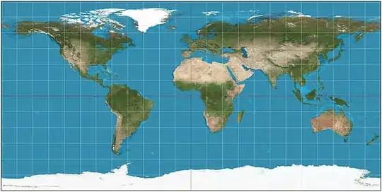

Every map projection type causes some kinds of distortion. It is inevitable. It's in the nature of geometry when taking a sphere and flattening it to a rectangle, or other flat shape. You can see this in the equi-rectangular map of Earth, where Greenland appears the same size as South America.
But that's of course wrong, an artifact of distortion. Take a look at the globe, or an area-preserving projection such as this cylindrical equal-area one, and you'll see that Greenland is actually much smaller than South America.
I illustrated this because, when it comes to points of light, distortions are not so obvious. You don't have the luxury of familiar terrain shapes like Greenland or continents, to tell distortion. So now I'll show a randomly generated starfield, in two projections.

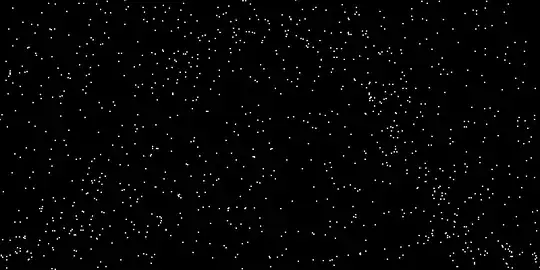

This is a random starfield in Cylindrical Equal-Area Projection.

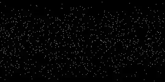

This is the same starfield in Equi-Rectangular Projection.
Both of them look pretty uniform, but the last one has a lack of stars near the poles. Without understanding what projection is used, and their pitfalls, you could think that the second one is not uniform.

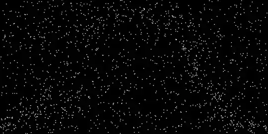

Now I'll show the actual starfield of our sky, based on the Yale Bright Star Catalog. Thanks to user:RobJeffries for pointing it out. I took stars from Sirius to 4.99 apparent magnitude. This was 1,602 stars.
It's a little difficult to discern, but there is a path where stars tend to cluster around the Milky Way. It's hard to see on the left side of the map. On the right side it's easier.
By the way, I did not draw brighter/dimmer stars differently, such as a smaller or grayer point of light. I wanted each point to show up just as well as each other point, because for one thing, I planned to look at each tier individually and in progressing composites.

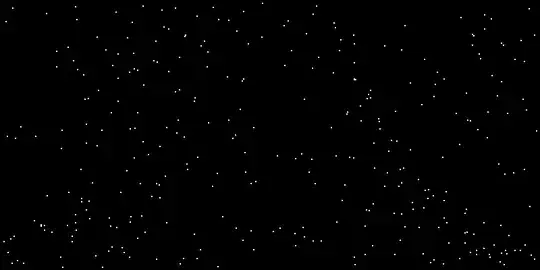

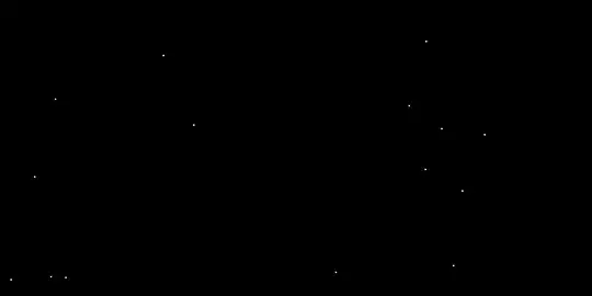

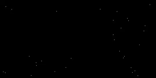

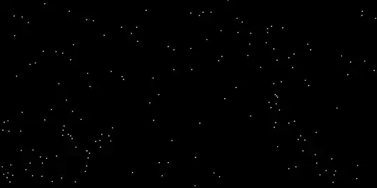

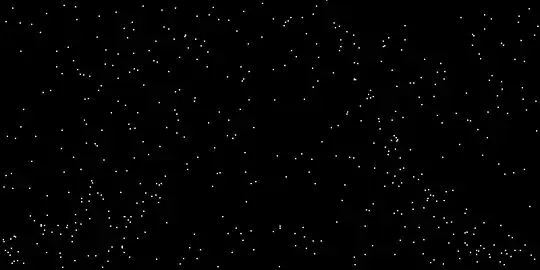

Here are the fields only looking at one tier at a time. There are 5. The first includes stars from Sirius to 0.99 apparent magnitude. The second goes from 1.0 to 1.99, etc, ending with 4.0 to 4.99.
In my opinion, the only one that could possibly be close to uniform distribution is tier 4, the stars with apparent mags from 3.0 to 3.99.

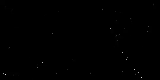

So now here are the composites. There are 3 of them. The first has tiers 1 and 2 composited together, The second has tiers 1 to 3, and the last has tiers 1 to 4. (All tiers, 1 to 5, was done in the original screen shot of our starfield.)
I suppose the closest one to uniform is the last one, but it's not as close as tier 4 by itself. I'm not really sure why that is or if it's just a coincidence.
