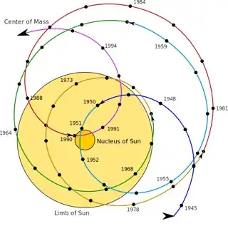

The barycentre of the whole solar system is inside the Sun roughly half the time, and outside the other half.
From Wikipedia's article:
To calculate the actual motion of the Sun, only the motions of the four giant planets (Jupiter, Saturn, Uranus, Neptune) need to be considered. The contributions of all other planets, dwarf planets, etc. are negligible. If the four giant planets were on a straight line on the same side of the Sun, the combined center of mass would lie about 1.17 solar radii or just over 810,000 km above the Sun's surface.
The associated image shows that the barycentre is not stationary in regards to the Sun, but moves. More properly, the Sun moves around the barycentre. Sometimes the barycentre is almost at the centre of the Sun and sometimes it's about twice the radius of the Sun from its centre.
For the barycentre to be much further from the centre of the Sun than currently believed, there would have to be an undiscovered Uranus-to-Jupiter mass planet in the solar system close enough to the Sun to make a difference. This hypothetical body would have an effect on the rest of the solar system. This is how some of the outer planets were discovered: some orbits were being noticeably perturbed by something. The search for the something led to the discovery of another planet.
If it turns out that Planet Nine exists and is discovered and is a super-Earth with a mass around five to ten times that of the Earth (compared with 14.5 for Uranus and 17 for Neptune), it would be so far away that its effects on the barycentre would be negligible. The four giant planets are much closer, and much more massive, so have a much more noticeable effect.
