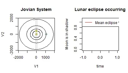

I set up a little animation of the Galilean moons (I didn't include the inner moons), and made a few assumptions (negligible moon size, sun at infinity, perfectly circular orbits) and found that there is a lunar eclipse in the Jovian system just under 10% of the time.
Animation of the galilean moons of Jupiter going into Jupiter's shadow
Here's a bigger version of the second graph. enter image description here

  • +n!Time is in hours? – uhoh Nov 23 '19 at 02:58
    @uhoh I didn't have a particular time unit in mind when I coded it, but it looks to be in days. Sorry about the poor quality animation, I had to severely sacrifice quality to get it under 2 mb. – Ingolifs Nov 23 '19 at 04:19

    @Ingolifs: Awesome animation. I can host a better quality version, if you wish. – Eric Duminil Nov 24 '19 at 11:13
  • @Hearth, including the innermost moons, a back of the envelope calculation finds that Metis, Adrastea, Amalthea and Thebe spend approx. 20%,19%,13% and 10% of their time in Jupiter's shadow respectively. There will be some overlap with each other and with the Galilean moons, so those percentages aren't strictly additive. Themisto and the outer moons of Jupiter are so far out, and have such high inclinations (typically $30^o$ to $50^o$) that they are basically never in Jupiter's shadow. – Ingolifs Nov 25 '19 at 00:47

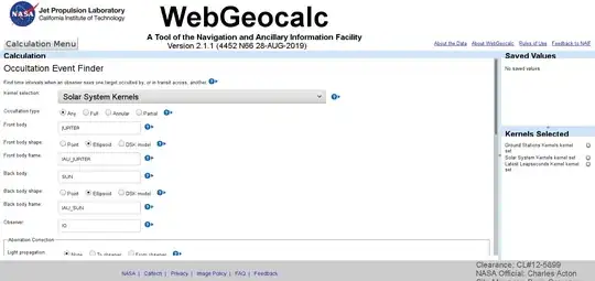

This not an answer, but, if you're extremely interested, you can use https://wgc.jpl.nasa.gov:8443/webgeocalc/#OccultationFinder with these parameters:
and others (you'll need to fill in other boxes, but that's fairly basic), you'll see when Jupiter blocks the Sun as viewed from Io, which means the Jovians will see an Io-nian lunar eclipse. You can use similar techniques for the other moons and/or use the CSPICE libraries (see http://astronomy.stackexchange.com/questions/13488/) to make your own calculations.
NOTE: for observer, make sure to use Io the moon, not Io the asteroid. The one with a number in front of it is the asteroid.
Of course, you could also use a planetarium program (like Stellarium) that lets you view the sky from Jupiter's moons (or even Jupiter itself-- I'm not sure Stellarium computes lunar eclipses, but it should)
