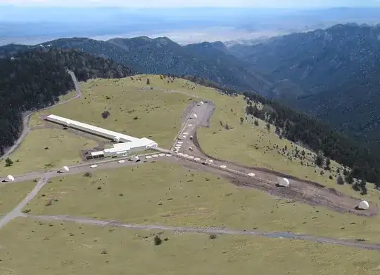

Magdalena Ridge Observatory Interferometer computer graphic overlay of the BCF building and the ten telescopes
Magdalena Ridge Observatory Interferometer computer graphic overlay of the BCF building and the ten telescopes Source
