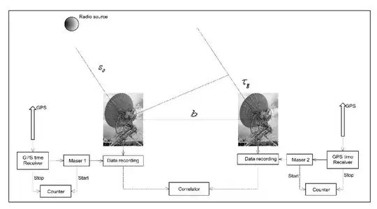

They don’t have to synchronize the atomic clocks at each telescope. Instead, they synchronize the collections using GPS (so the telescopes observe the same target in the same frequency range at the same time), as shown in the diagram from this paper.
When the data is brought together, they use differences between the arrival times of quasar data to calculate relative antenna locations. From this paper from NASA:
During geodetic VLBI observations, signals emitted by distant sources of radio frequency energy (quasars) are received and recorded at several antennas. At each antenna (VLBI station) a very stable frequency standard (hydrogen maser) provides a reference signal that enables time tagging of the quasar signals as they are being recorded. For each VLBI experiment, correlation of the time-tagged, recorded information from the participating antennas yields the differences among the arrival times of any specific quasar radio wave at the antennas. These time differences are used to calculate the locations of the antennas with respect to each other.
