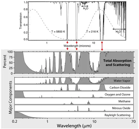

I'm just going to expand and deepen on what the other answers already said.
In the following I contrast the atmospheric transmission ($T$) and absorption ($A$, which is $A=1-T$) of Mars and Earth. The Mars plot (top) is from Prof. J. Irwin via this review by P. Read et al. 2015 and the terrestrial data (bottom) is from wikipedia.
The plots of $A$ and $1-T$ area easily matched by eye when comparing $T=0$ and $A=1$ for Mars and Earth. To make this superclear, I've added arrows to mark the $CO_2$ absorption bands.
Additionally, the plot for Mars has the energy spectra of the incoming solar (T=5800 K) and outgoing infrared (T=216 K) radiation inserted. Earth's outgoing infrared radiation from the surface would be at T=300K, and in this graph at nearly the same position. For a strong greenhouse effect, an atmosphere must absorb the majority of this outgoing peak.
Mars and Earth atmospheric windows
From this we learn a few things:
1.) Looking at Earth, we see that there are several important greenhouse gases in the atmosphere, but the most significant one is water.
2.) A significant portion of Earth's greenhouse peak is absorbed by $H_2O$+$CO_2$, while only a small fraction is absorbed by the martian atmosphere, visually explaining what already @pelas answer noted, that Mars has a weak greenhouse effect.
3.) If comparing the width of the $CO_2$ absorption bands very carefully, then one will note, that the $CO_2$ bands for Earth are broader than on Mars, although Earth's atmosphere has much less total $CO_2$ in it! This is an effect of the so-called 'pressure broadening' of atmospheric lines, enhancing their greenhouse capability significantly. Pressure broadening becomes important in atmospheres at pressures of about $0.1-1 \; bar$ (rough rule-of-thumb). This is another reason why the low mass/pressure of the martian atmosphere cannot create a strong greenhouse effect, as the pressure is around $0.01 \; bar$ on the surface.
AtmosphericPrisonEscape
  • 9,840
  • 42
    While it has little to do with the question, I'm curious why Methane is such a strong greenhouse gas with a relatively small absorption spectrum in the chart above. Nice details by the way. – userLTK Oct 09 '19 at 14:10
    @userLTK There is not enough methane in the atmosphere to saturate those absorption bands (yet). The optical depth $\tau_{\lambda}$ at a given wavelength $\lambda$ and height $z$ is $\tau_{\lambda}=\int_{\infty}^{z} dz' n(z') \kappa(z')$, with $n(z')$ being the local number density and $\kappa(z')$ the opacity per mole, which is again a function of the temperature. Only at $\tau_{\lambda}>1$ is the photon mean-free path smaller than the atmospheric scale (which means the photon can't escape), and we see that both the absorption strength (given by the opacity) and the amount of gas contributes. – AtmosphericPrisonEscape Oct 09 '19 at 14:42
  • Am I correctly understanding that first graph, that even as sparse as the Martian atmosphere is, almost no light makes it through the CO₂ absorption spectrum in the middle of the outgoing infrared at ~15μm? – MichaelS Oct 10 '19 at 09:31
    @MichaelS: Right, this band at $15\mu m$ is opaque, so the outgoing radiation gets trapped there. But this is only a small fraction of the total black body energy, so it doesn't contribute to a strong greenhouse effect. – AtmosphericPrisonEscape Oct 10 '19 at 10:18
    It might improve this answer is you explicitly mention that the bottom graphs are Earth, the top is Mars, and the Mars absorption graph is "upside down" compared to Earth graphs (Earth graphs "absorption and scattering", while Mars measures "transmission"). Great answer! – Yakk - Adam Nevraumont Oct 10 '19 at 17:22
    @Yakk-AdamNevraumont: Thanks, but that's literally my first two sentences. – AtmosphericPrisonEscape Oct 10 '19 at 18:06
