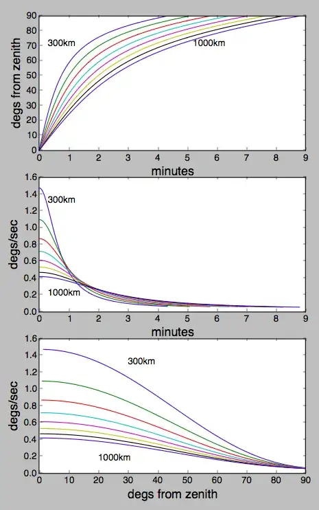

  • What was your field of view roughly? Can you mention some info about your telescope so it can be estimated? Focal length of telescope and eyepiece, or total magnification? For example if the focal lengths are 800 and 20 mm that's 40x, and if the eyepiece has say a 50 degree field of view then your actual field of view was 1.25 degrees and the speed was about 0.4 degrees per second. That does sound like an artificial satellite, and doesn't sound like anything else that I can think of. – uhoh Oct 05 '19 at 06:01

As mentioned in this comment if you were using low power, say 40x with a 50 degree apparent FOV eyepiece that would be about 0.4 degrees per second which is in the ballpark of the apparent motion of an artificial satellite in low Earth orbit (LEO).
A geostationary satellite (GEO) or even a geosynchronous one would move much more slowly relative to Saturn, and if your telescope wasn't motorized, it would appear in a fixed position even as Saturn slowly moved across your field of view due to Earth's rotation.
In the bottom plot below, taken from this answer it shows that 0.4 degrees per second is quite reasonable for satellites with a wide variety of altitudes. For satellites in LEO between 300 and 1000 km and viewing angles from zenith to near-horizon apparent motion can range from below 0.1 to over 1.4 degrees per second.
