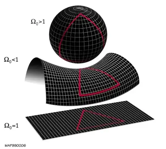

In short: no one knows for sure, but currently it looks that the probability is 1.
Longer: On our current understanding, the Universe is probably infinite in space. This depends on the recent WMAP satellite results, which have shown a zero curvature of the Universe below measurement precision. The other two options were a positive curvature (thus, we would live a 4D sphere), or a negative:
If the curvature is exactly zero (the last option on the picture), or it is negative, and the Universe doesn't have some exotic topology, then it is infinite.
And an infinite Universe has infinite many stars, thus it doesn't matter, where do you see, somewhere you will find a star.
However, most likely you have no option to actually see it - it is nearly surely over the cosmological horizon, thus there is no way to get any information from it, or interact with it in any sense, due to the expansion of the Universe. Note, the currently accelerating expansion continuously reduces even the count of the stars inside the cosmological horizon.

    @Carl-FredrikNybergBrodda: Note that Olber's Paradox is based on notions of homogeneity and isotropy, which together are known as the Cosmological Principle. It's generally presumed true, even if it's not logically guaranteed. This paper from 2016 suggests odds of 120000:1 in favor of isotropy. – MichaelS Sep 09 '19 at 09:36
    There's zero evidence or rationale here to support that the universe is "sufficiently large" for this to work out. How big is big enough? – Nuclear Hoagie Sep 09 '19 at 13:22
