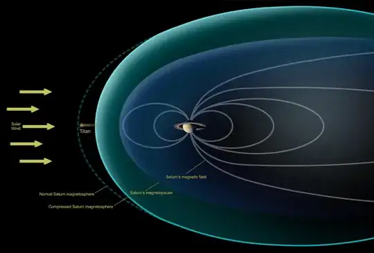

Atmosphere: "Saturn's moon Titan and Jupiter's moon Io have atmospheres and are subject to atmospheric loss processes. They have no magnetic fields of their own, but orbit planets with powerful magnetic fields, which protects these moons from the solar wind when its orbit is within the bow shock. However Titan spends roughly half of its transit time outside of the bow-shock, subjected to unimpeded solar winds. The kinetic energy gained from pick-up and sputtering associated with the solar winds increases thermal escape throughout the transit of Titan, causing neutral hydrogen to escape.15 The escaped hydrogen maintains an orbit following in the wake of Titan, creating a neutral hydrogen torus around Saturn.".

June 13 2007
On June 13 2007 (and other dates) Titan ventured outside of the protection of Saturn's magnetic field, it remained temporary magnetized for 3 hours. It happened that Cassini was in a good position to get a few photos (scroll to the bottom).

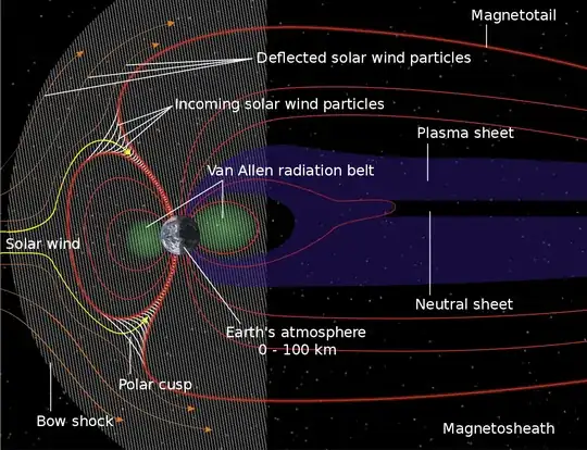

Earth's magnetic field protects it from solar wind
Earth's magnetic field protects it from solar wind, and preserves our atmosphere.
