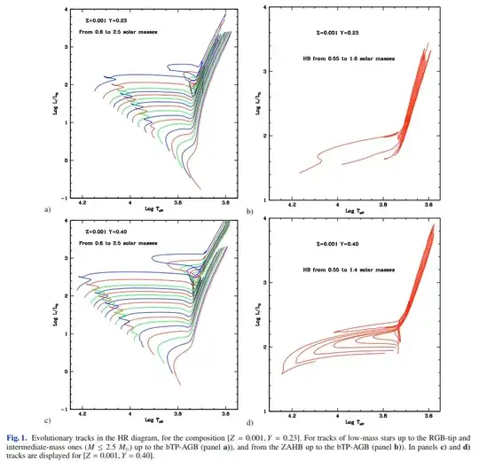

What you are looking seems to be the vertical path of a star in the Hertzsprung-Russel diagram (HRD).
The only problem is that stellar evolution is pretty complicated. See here a few simulated trajectories for different masses and chemical compositions from Bertelli et al. 2008
Especially before and after the main sequence (i.e., regular boring hydrogen burning) the luminosity evolution becomes extremely variable.

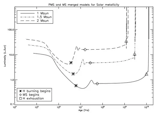

From the simulations above one can also derive respective age-luminosity relations (taken from Danchi 2013):
age-luminosity
Again, you can see that the relation is very complicate for young or old stars and is fairly constant during the main sequence. The problem is, that it changes too little during most of the main sequence. So for most stars even with good mass and metallic measurement you won't be able to accurately estimate age just from luminosity. In addition to that, there are still uncertainties in our models.
