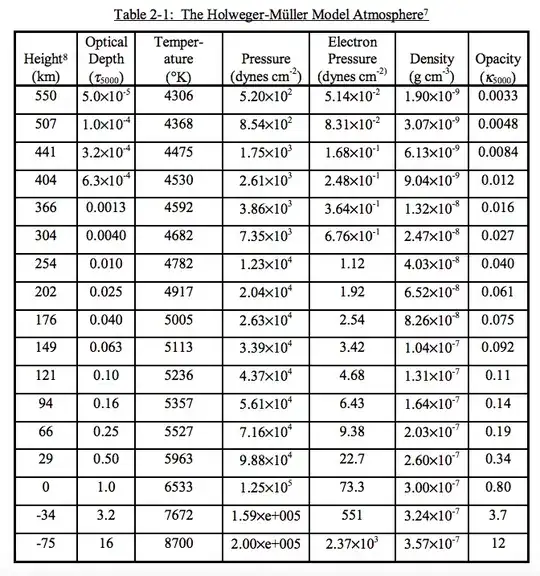

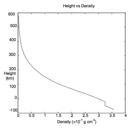

The density of the photosphere at $\tau_{5000}=1$ is predicted to be $3 \times 10^{-7} \text{g/cm}^3$ in the Holweger-Müller Model Atmosphere7.
As pointed out in comments there is a spread in values here.
The 1E-06 g/cm^3 density value (plot) is more consistent with = 1 or "bottom" of the photosphere, while the density in the quote is more consistent with the cooler "top" of the photosphere (circa 4300 K).
From Chapter 2: The Photosphere of Timo Nieminen's thesis Solar Line Asymmetries: Modelling the Effect of Granulation on the Solar Spectrum
density versus hight above the Sun's surface
density and other parameters versus hight above the Sun's surface
Figure 2-3: The Holweger-Müller Model Atmosphere
7 Holweger, H. and Müller, E. A. “The Photospheric Barium Spectrum: Solar Abundance and Collision Broadening of Ba II Lines by Hydrogen”, Solar Physics 39, pg 19-30 (1974). Extra points have been cubic spline interpolated by J. E. Ross. The optical properties (such as the optical depth and the opacity) of a model atmosphere are, obviously, very important, and will be considered later. See table C-4 for complete details of the Holweger-Müller model atmosphere including all depth points used.
8The height scale is not arbitrary. The base of the photosphere (height = 0 km) is chosen to be at standard optical depth of one (i.e. 5000Å = 1 ).

    The HM atmosphere perfectly well shows that the "photosphere" covers a range of temperatures and densities. The density at the temperature minimum is around $10^{-9}$ g/cc and increases as you go inwards. The quote and picture are consistent. – ProfRob Jul 20 '19 at 07:32
    The quote is open to misinterpretation, but it isn't incorrect if the photosphere is defined by that range of temperature. – ProfRob Jul 20 '19 at 08:13
  • @RobJeffries I'd meant to delete that; I went off and made an edit, how does it look now? – uhoh Jul 20 '19 at 08:16
The density is what you read from the graph, correctly. Don't worry about what it says in that quote, it's all just a matter of what is meant by the "photosphere", a term that is rather vaguely defined and used to mean different things in different places. You can see the problem in the temperatures used in that quote-- they correspond to what the graph considers to be entirely above the photosphere. The quote seems to think of the photosphere as the region from the tau ~ 2/3 point to the minimum in the temperature, whereas the graph seems to think of the photosphere as something quite noticeably hotter. Other places regard the photosphere as a shell of zero width, right where tau ~ 2/3. It's all just the different ways the word is used, there's nothing to worry about. The graph matches up density with height and temperature, so you can just use that-- and note that even that is a kind of average situation, the reality is much more complicated.
