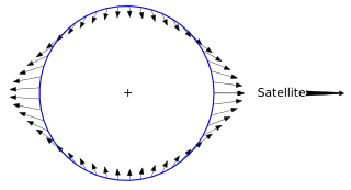

Instead, let's think about the size of the Earth, and the fact that people on the near side will be closer to Jupiter than the center of mass of the Earth, and people on the far side will be farther away.
Since people nearer to Jupiter will feel a slightly stronger acceleration than the center of mass of the Earth, they will feel a quite gentle tug. We'll calculate that in a minute.
But believe it or not, people on the far side of the Earth, feeling less of a tug than the Earth's center of mass, will believe they are being pulled in the opposite direction! They won't really be pulled away from Jupiter, but they will not accelerate towards Jupiter as fast as the Earth, and so it will feel like they are being repelled.
This kind of force is called a tidal force and this is the picture that's often used with the concept:
enter image description here Source Replace "Satellite" with "Jupiter"
