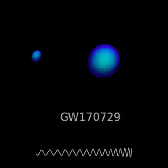

From the question What can be learned from, or noted in this LIGO Orrery video? we can watch the video LIGO Orrery (which was inspired by the mind-blowing Kepler Orrery IV).
I've made a small, low quality GIF from screen shots here, the video is much more interesting.
It's been difficult to be sure what exactly is depicted as mentioned in this answer but it's likely the surfaces depict something at least a bit like an event horizon.
