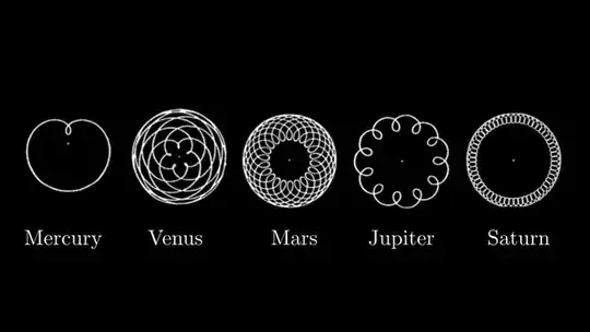

Few days a go, I came across these two pictures of paths of planets as observed from Earth. They have a perfect geometric shapes. Actually, to me they look so beautiful and perfect, that they appear fake or made by a pseudo-scientist or some propaganda society (e.g. flat Earth like community people) who talks about divine geometry etc.
Auxiliary questions: Is this the reason, why Earth was consider to be in the center of the solar system?
