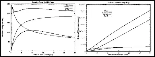

The amount of dark matter required at different radii (assuming Newtonian gravity is the correct formulation) is deduced from the rotation curve. The image below, courtesy of Nick Strobel at www.astronomynotes.com, shows a sketch of the current thinking on how much dark matter needs to be at what radius (labelled as "Corona") and takes the dark matter to be distributed spherically symmetrically.
Dark matter already "outweighs" luminous matter by 2:1 at the solar radius, yet there is room for only 10% of the local density to be in a "dark" form of any kind.

  • Um. I see the assertion that the dark matter is distributed spherically. What I want is some sort of computer modelling to back it. Best as I recall the models have the matter ending up in a disk. Not seen one where the dark matter is distributed differently. – Blame Apr 14 '19 at 15:13

  • @blame All dark matter galaxy halo models are pseudospherical in shape. e.g. https://en.m.wikipedia.org/wiki/Navarro–Frenk–White_profile The dark matter doesn't follow the luminous matter because there is 10 times as much dark matter and it is dissipationless. – ProfRob Apr 14 '19 at 15:29
  • I have given you a paper that shows there is hardly any dark matter in the disk. @blame – ProfRob Apr 14 '19 at 15:32
