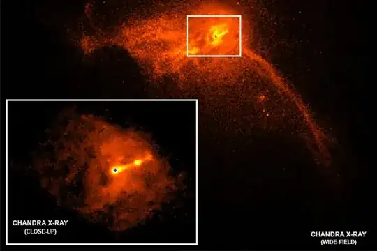

To see more context, here is a wider view of M87 taken by Chandra, and from the Chandra team's blog post:
Chandra was used to observe M87 and other targets during the EHT campaign. While Chandra can’t see the shadow itself, its field of view is much larger than the EHT’s, so Chandra can view the full length of the jet of high-energy particles launched by the intense gravitational and magnetic fields around the black hole. This jet extends more than 1,000 light years from the center of the galaxy.

  • Anyone know what the scale of the Chandra images is? – Steve Linton Apr 14 '19 at 13:48
