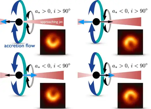

No, you aren't seeing the shape of the accretion disk. Although its plane is almost that of the picture it is far larger and fainter than the ring that is seen. The reason for this asymmetry is almost entirely due to Doppler beaming and boosting of radiation arising in matter travelling at relativistic speeds very close to the black hole. This in turn is almost entirely controlled by the orientation of the black hole spin. The black hole sweeps up material and magnetic fields almost irrespective of the orientation of any accretion disk.
The pictures below from the fifth event horizon telescope paper makes things clear.
Relative orientation of spin and accretion flow
The black arrow indicates the direction of black hole spin. The blue arrow indicates the initial rotation of the accretion flow. The jet of M87 is more or less East-West (projected onto the page), but the right hand side is pointing towards the Earth. It is assumed that the spin vector of the black hole is aligned (or anti-aligned) with this.
The two left hand plots show agreement with the observations. What they have in common is that the black hole spin vector is mostly into the page (anti-aligned with the jet). Gas is forced to rotate in the same way and results in projected relativistic motion towards us south of the black hole and away from us north of the black hole. Doppler boosting and beaming does the rest.
As the paper says:
the location of the peak flux in the ring is controlled by the black hole spin: it always lies roughly 90 degrees counterclockwise from the projection of the spin vector on the sky.

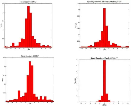

In the paper "Measurement of the spin of the M87 black hole from its observed twisted light" (Apr 16 2019) by Fabrizio Tamburini, Bo Thidé, and Massimo Della Valle, they explain on page 2:
... The imaging techniques applied to this data set reveal the presence of an asymmetric ring with clockwise rotation and a “crescent” geometric structure that exhibits a clear central brightness depression. This indicates a source dominated by lensed emission surrounding the black hole shadow.
From the analysis of the two data sets we obtain the asymmetry parameters $q_1$ = 1.417 for epoch 1 and $q_2$ = 1.369 for epoch 2. They give an averaged asymmetry in the spiral spectrum of $\bar{q}$ = 1.393±0.024 in agreement with that of our numerical simulations, $q_{num}$ = 1.375, of partially incoherent light emitted by the Einstein ring of a Kerr black hole with $\boldsymbol{a} \textbf{~}\!$ 0.9±0.1, corresponding to a rotational energy $^{[10]}$ of $\textbf{10}{^\textbf{64}}\!$ erg, which is comparable to the energy radiated by the brightest quasars (~ 500 trillion $\odot$) over a Gyr (billion year) timescale, and inclination $i$ = 17° between the approaching jet and the line of sight, with the angular momenta of the accretion flow and of the black hole anti-aligned, showing clockwise rotation as described in Ref. 5.
This result is in good agreement with results from the analysis of the fiducial pipeline images of amplitude and phase plots for 11 April, 2017 of DIFMAP with $q$ = 1.401, EHT $q$ = 1.361 and SMILI, $q$ = 1.319, $^{[6]}$ giving for that day an averaged value $\bar{q}$ = 1.360 that deviates of 0.09 from epoch 2 value estimated with TIE and $q$ > 0 confirm the clockwise rotation. The spiral spectra are reported in Fig. 2.
Then one determines the rotation parameter $a$ by comparing those obtained by a linear interpolation with the asymmetry parameter $q$ of various models, as reported in the numerical example of Table I for different values of inclination and rotation parameters $i$ and $q$. The results are depicted in Fig. 1.

Figures:
Figure 1
Figure 1. Experimental results. Field components along the observer’s direction and spiral spectra obtained with the TIE method for epoch 1 and epoch 2. The asymmetry between the $m$ = 1 and $m$ = −1 components in both of the spiral spectra reveals the rotation of the black hole in M87. It also indicates that the electromagnetic vortex reconstructed from the TIE analysis of the EM field intensities extracted from the brightness temperature in a finite frequency bandwidth has components along the propagation direction to the observer that are compatible with twisted lensing of a black hole with $a$ = 0.9±0.1 rotating clockwise with the spin pointing away from Earth and an Einstein ring with a gravitational radius $R_g$ = 5, as indicated by an EHT analysis dominated by incoherent emission. For all days, the diameters of the ring features span the narrow range 38–44 µ-arcseconds and the observed peak brightness temperature of the ring is $T$ ∼ 6×10$^9$ K.$^{[6]}$ The other components ($x$ and $y$) of the EM field derived from TIE equations do not show a predominant OAM component. This is expected $^{[1]}$.
Figure 2
Figure 2. Results from DIFMAP, EHT and SMILI data analyses and of numerical simulations from KERTAP. The first three insets show the experimental spiral spectra obtained from the three fiducial pipeline images for 11 April 2017 from SMILI, EHT imaging, and DIFMAP $^{[4]}$. They represent the visibility amplitude and phase as a function of the vector baseline. In all the datasets the asymmetry parameter, the ratio between the $m$ = 1 and $m$ = −1 peaks in the spiral spectra, is $q$ > 1 indicating clockwise rotation: the black hole is found to have its spin pointing away from Earth and an inclination between the approaching jet and the line of sight of $i$ = 17° (equivalent to a similar geometry with an inclination $i$ = 163°, but where the angular momentum of the accretion flow and that of the BH are anti-aligned) (left). Fourth inset: spiral spectrum of the numerical simulations with KERTAP $^{[29]}$ obtained from the normalized intensity and phase of the $z$ component of the radiation field emitted from a spatially resolved image of the black hole accretion disc dominated by thermalized emission with Γ = 2. The coherence χ of the radiation emission is characterized by the ratio between the $m$ = 0 and $m$ = 1 peaks in the spiral spectra. The lower the χ, the higher the coherence in the emission. The experimental spiral spectra of SMILI, EHT imaging, and DIFMAP show higher coherence in the radiation emission (χ$_\text{SMILI}$ = 1.198, χ$_\text{EHT}$ = 1.798) and (χ$_\text{DIFMAP}$ = 1.107) with respect to the simulated model of a simple thermalized accretion disk with power spectrum Γ = 2 (χ$_\text{KERTAP}$ = 5.029) and with respect to that obtained in the TIE reconstruction of the wavefront (χ$_\text{ep1}$ = 13.745 and χ$_\text{ep2}$ = 14.649) in Fig.1. Even if the asymmetry $q$ is well preserved, the TIE method can be improved by consecutive data acquisitions of the wavefront, separated by a much shorter time interval than one day and might therefore provide better information on the source emission.

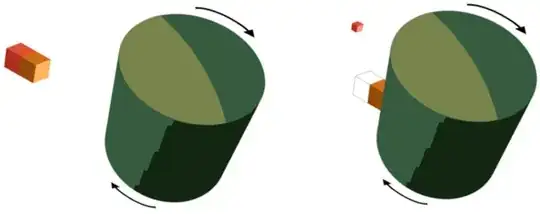

Simplified Penrose Explanation
"Figure 8: The carousel analogy of the Penrose process. A body falls nearly from rest into a rotating cylinder, whose surface is sprayed with glue. At the surface the body is forced to co-rotate with the cylinder (analog therefore of the BH ergosphere, the surface beyond which no observer can remain stationary with respect to infinity). The negative energy states of the ergoregion are played by the potential energy associated with the sticky surface. If now half the object (in reddish) is detached from the first half (yellowish), it will reach infinity with more (kinetic) energy than it had initially, extracting rotational energy out of the system.".
