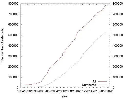

Assuming exoplanets have been discovered at a constant rate since 1995 (not very true) then the rate is very approximately 117 exoplanets a year. Comparing to the Minor Planet Center (MPC) archive stats which are plotted below:
which shows that approx. 761,000 asteroids of all types have been discovered since 1995 April or roughly 22,000 a year. (The lower black line is for the smaller number of asteroids that have been seen enough times and the orbit is secure enough that they can be numbered).
