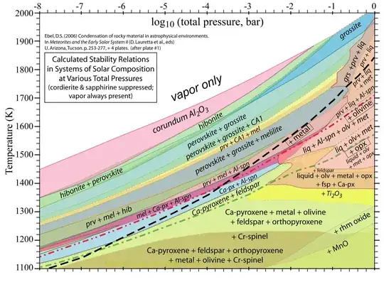

The diversity of planets reflects in part the diversity in terms of chemical composition of the protoplanetary disk. We know that UV radiation from the sun can dissociate complex molecules or even very simple ones; for example, when UV rays split water molecules the result is free hydrogen and oxygen atoms. Since hydrogen is extremely lightweight they can be transported easily on the flux of stellar winds. So water, to keep with that example, if close to the sun could end up been dissociated and depleted from the region of the disk, but above the so called "snow line" UV radiation from the Sun was so weak that this couldn't happen as often and thus water molecules (which are very heavy in comparison to single hydrogen atoms), stayed there. That only explains the dichotomy between interior and exterior planets in terms of water content, and even then, some processes (like the late heavy bombardment) might add some water to the interior (as it happened on Earth). But this reasoning is not only for water, carbon dioxide, ammonia, methane and hundredths of different molecules have their own "frost lines". Closer to the sun the carbon can't be methane is a volatile gas that gets quickly pushed outwards, but at some tenths of AUs methane can remain in stable conditions and can even condensate into liquid droplets.
All of this just to say that the protoplanetary disk was NOT homogenous in terms of chemical composition, and was not homogeneous in terms of density or pressure. The thermal and chemical gradient across the nebula ensures some diversity and complexity for the entire planetary system.
Here you have a beautiful diagram showing how different chemical compounds could condensate in different temperatures and pressures on the protoplanetary disk.
