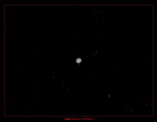

There is no "best" camera as it really depends on the subject you intend to image and the optical instrument you intend to use with it. This could turn into a very long answer, so I'll try to offer a short response first and then offer a bit more to consider.
For planetary imaging, use a camera capable of doing video frames and this does not need to be a camera with a large chip or high resolution. Jupiter, for example, is just fractionally under 44 arc-seconds diameter when viewed at opposition. (compare to the moon at roughly 30 arc-minutes or more than 40x the angular width).
Typically you'd capture perhap 30 seconds to a couple of minutes worth of frames and then feed those frames into stacking software. Ideally the video frames use a "lossless" format. Several image processing applications can stack the frames (e.g. AutoStakkert & Registax are popular and free).
A camera such as the ZWO ASI120MC-S is very popular and in your budget. There's the ASI290MC for those with deeper pockets (and versions for those with much deeper pockets). From QHYCCD there's a QHY5R-II ... more to the entry-range with lower resolution and a smaller chip.
Ideally your scope would be on a motorized equatorial mount so that it keeps the object in your field of view (otherwise the object will quickly drift out of the camera frame. For this scope & field of view combination, that would happen in about 45 seconds for a planet in the "center" of the frame to drift out of frame completely). If using a 2x barlow, it would happen in about half the time.
Simulated field of view using 80/900 refractor & ZWO ASI120MC-S camera
A barlow is usually used for planetary imaging (the simulated field of view did not use a barlow). To understand why, you'd want to read about Shannon-Nyquist sampling theory and how it applies to astrophotography.
