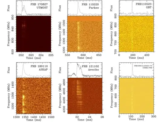

Astronomer Emily Petroff (informative website) studies FRB time structure and has recently commented on the rapidly increasing number and diversity of observations of FRBs in twitter.
These show that in addition to the overall widths several milliseconds for the dispersion "corrected" (or compensated) spectral histograms, there is finer structure at order 100 microseconds and possibly below!
When you correct for this DM and extract the intrinsic pulse, we see that some FRBs have structure in the pulse, but some don't
https://twitter.com/ebpetroff/status/1118815497066303493
