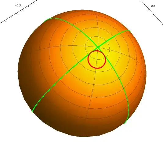

Imagine that you are at 80 degrees north and 0 degrees east (on the Prime Meridian).
It is only 10 latitude degrees from you to the north pole.
Notice that the distance from you to the 45th meridian (shown in green) is about 7 latitude degrees ($\sin{\pi/4}\cdot 10$) because if you walked to the closest point on the 45th meridian, the north pole would be directly to your left and the three points 1) the closest point on the 45th meridian, 2) the north pole, and 3) 80 degrees north on the prime meridian almost form an isosceles 45-45-90 triangle.
If you draw a circle around the position (80 North, 0 East) with radius of 7 latitude degrees, the maximum latitude would be 87, the minimum latitude would be 73, the maximum longitude would be about 45 degrees east, and the minimum longitude would be about -45 degrees (45 degrees west).
Also, the point on the 45th meridian closest to your starting position (80N 0E) would have a latitude of about 83 degrees, not 80 degrees.
The example above illustrates that the spacing between longitude lines gets closer near the poles.
In general, if you are at the position ($\delta$ north, $\alpha$ east) and you draw a circle around yourself with "radius" $\rho$, then the min/max latitude/longitude of the enclosed points would be $\delta-\rho$, $\delta+\rho$, $\alpha - \gamma$, $\alpha + \gamma$ where $$ \gamma = \mathrm{arcsin}\left(\frac{\sin\rho}{\cos\delta}\right). $$ (where $\rho$ is the angle between you and the edge of the circle as seen from the center of the Earth). Notice that
  • if $\delta=0$, then $\gamma=\rho$,
  • $\gamma\geq\rho$,
  • if $\pi/2-|\delta|=\rho$, then $\sin\rho=\cos\delta$ and $\gamma=\mathrm{arcsin}(1)=\pi/2$, and
  • if $\pi/2-|\delta|<\rho$, then there is no solution for $\gamma$ because a pole is enclosed by the circle.
The formula can be derived from dot products between your position vector and the vector perpendicular to the either extreme meridian. I need to do a lot of visualization and to fix several false starts to get it right.
For the original example of a circle around 80N 0E with radius 7 degrees, the formula yields $$ \gamma = \mathrm{arcsin}( \sin(7\pi/180)/\cos( 80\pi/180))\cdot180/\pi = 44.573 \mathrm{\ degrees} $$ which is close to the estimated 45 degrees.
