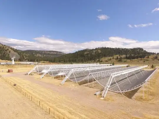

Figure 1. Photograph of the CHIME telescope on 15 September, 2016, looking North-West. The shipping containers housing the X-Engine and CHIME/FRB backend can be seen adjacent to the right-most cylinder. The receiver huts containing the F-Engine are beneath the reflectors and cannot be seen here. The DRAO Synthesis Telescope (Kothes et al. 2010) can be seen in the background. See Table 1 for detailed properties of CHIME.

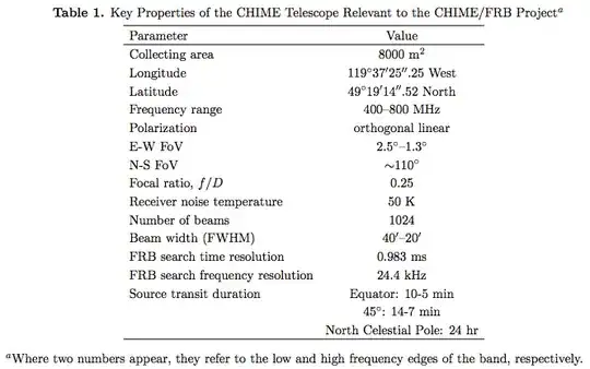

The Field of View in the North-South direction (the axis of the parabolic cylinders) is about 110 degrees, but in the East-West direction it's of course very narrow, only 2.5 to 1.3 degrees.

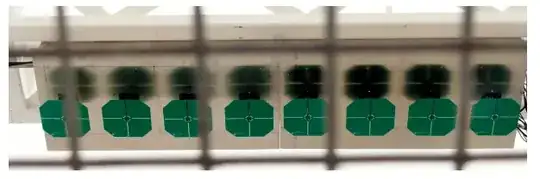

Fig. 3. A linear array of eight cloverleaf antennas installed at the focal line of the CHIME Pathfinder at the Dominion Radio Astrophysical Observatory in Penticton, BC, Canada. The picture is taken through the wire mesh reflective surface (mesh spacing 19 mm) illustrating a photonsview of the antennas and ground plane. Notice that each feed has an image-feed in the ground plane, 1/2 λ away at the passband centre frequency. Notice also the four slots cut to remove dielectric material from the gaps between the petals.

CHIME consists of four adjacent 20m x 100m cylindrical reflectors oriented north-south. The focal axis of each cylinder is lined with 256 dual-polarization antennas, each of which receives radiation from a large swath of sky that nearly stretches from the northern horizon to the southern horizon. This gives CHIME its enormous field of view. The CHIME antennas are custom-designed to have good sensitivity from 400 to 800 MHz, in both linear polarizations. This gives CHIME its large frequency coverage. Signals from the antennas are amplified in two stages, using low-noise amplifiers developed by the cell-phone industry. This novel application of consumer technology makes CHIME affordable. The 2048 signals from these inputs (256 antennas x 2 polarizations x 4 cylinders) are fed to the F-Engine for the initial stage of digital processing.
