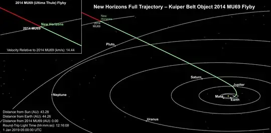

1. New Horizons is really far away from the Earth.
At the moment of closest approach, New Horizons was over 6,600,000,000 kilometers away from Earth. This is about 6 light-hours. And the spacecraft is continuing to get farther by about 14 kilometres per second.
Solar system diagram of the location of NH at around the time of the closest approach

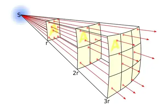

2. Transmissions from farther away are weaker.
The inverse square law states that the intensity of things like radio signals and sources of light (energy per unit of area perpendicular to the source) is inversely proportional to the square of the distance. That means doubling the distance results in us receiving only a quarter of the energy.

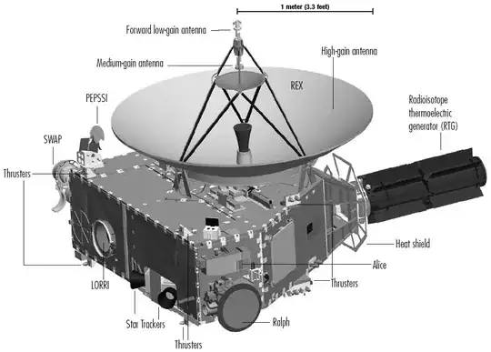

3. New Horizons only has so much power to work with.
The spacecraft is powered by a single RTG (radioisotope thermoelectric generator) that contains ~11 kg of Plutonium-238. At launch, this produced 245 watts (at 30 volts of direct current) of power, but due to radioactive decay, this decreased to 200 watts by the time of the July 2015 Pluto flyby, and further to 190 watts by the time of the January 2019 MU69 flyby.
For data transmission, it has a 2.1-meter diameter high gain dish antenna, a 30-centimeter diameter medium-gain dish antenna, and two broad-beam, low-gain antennas. The high-gain beam is 0.3 degrees wide, and the medium-gain beam is 4 degrees wide (used in situations when the pointing might not be as accurate). New Horizon's radio system is powered by a TWTA (Traveling Wave Tube Amplifier), which consumes 12 watts. (That's about the same as a modern CFL light bulb!)
New Horizons labelled diagram
There are actually two TWTAs for redundancy; one with left-hand circular polarization, and one with right-hand circular polarization. After launch, they figured out a trick to use both TWTAs at the same time, which increased the data transfer rate by 1.9 times. They used this two-TWTA mode to get all the data back from the Pluto flyby more quickly.

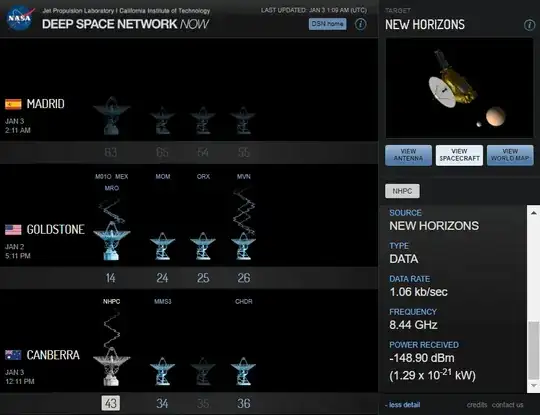

NASA has a neat interactive page that shows what each antenna in the DSN is doing right now. Here's a screenshot from January 3, 2019, 01:11 UTC:
Canberra 70-m dish is talking to new Horizons, with data rate 1.06 kb/s, frequency 8.44 GHz, and power received -148.90 dBm
As you can see, the signal that this dish is receiving from New Horizons is only 1.29E-18 W in strength. That's 1.29 attowatts. That's extremely weak.
So, as a result of the faint signal, it looks like the people at NASA decided to restrict the downlink rate at about 1000 bits per second (125 bytes per second), as an optimal balance between data integrity and downlink speed.
