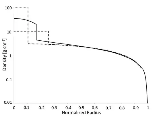

Below is a model density profile for Jupiter (solid line). Jupiter density profile
Just looking at this I would say that $\alpha$ is just a bit $<-1$ for most of the interior and so the gravity should be increasing slowly as $r$ decreases, but there is a sharp uptick in density at the boundary to the core which would see $\alpha \ll -1$ and the gravity becoming proportional to $r$ to the power of a negative number (i.e. increasing strongly with decreasing $r$), but then must drop to $g=0$ when $r=0$ shortly afterwards.
