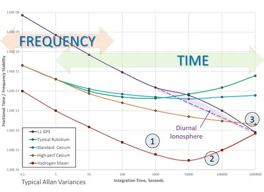

If we use an observing frequency of 10 GHz (10e9 Hz) and want to keep the phase coherent to ~10 degrees (out of the 360 degrees) after 1000 seconds integration then you need 10 / (360 * 10 * 1e9 * 1e3) or 10 / 3.6e16 or a clock stability of about 2.8e-15. Higher frequencies such as the 230 GHz mentioned in the comment will be even more demanding.
If you look at Allan Deviation/Variance plots, which measure the stability of clocks, such as the plot on slide 4 (and copied below): Allan Deviation plot this level of performance at 1000 seconds is only reached by hydrogen masers. The typical GPS Disciplined Oscillator will be at about 1e-12@1000seconds, see this recent comparison of 17 GPSDOs. With careful correction of the sawtooth error caused by the internal oscillator of the GPS (discussed at the end of the presentation) you can improve the typical 50 ns jitter of GPS to ~5 ns. Beyond this atmospheric/ionospheric effects come in and you need to use a dual-frequency GPS to take those out.

  • You also need phase coherence for times much shorter than 1000sec. Up to the sampling times as well (few nsec). Hydrogen masers don't have very good short term stability so usually crystal oscillator is used for subsecond stability and the signal is 'disciplined' by the maser. Ultimately the maser is needed as a frequency standard rather than for absolute time synchronization. – Chris May 28 '21 at 04:54
