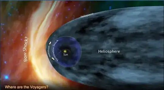

The Nose.
The ""Nose" of the solar system is sometimes used to refer to the direction of travel of the local galactic wind. Just as a comet's tail points away from the sun, the tail of the Heliopause points away from the wind, the nose points in the direction it's coming from.
The nose is as you have stated is pointing towards Scorpius.

  • so if i was looking in the direction of the center of the bow shock I would not necessarily be pointing in the direction of the solar apex? – Bob516 Dec 09 '18 at 04:13
    @Bob516 The, direction of the galactic wind is variable and chaotic. The trend is that it "blows" out from the central supermassive black hole's accretion disk, but since each moving star locally contributes to it, plus energetic events elsewhere within the galaxy, It's not easy to predict it's exact vector, especially since we don't have any extra-system observers. IBEX is the best we've got at present. – Jiminy Cricket. Dec 09 '18 at 04:32
    @Bob516 Without getting into where you are in which hemisphere at what time of year. If you look out at the stars and you can pinpoint Hercules, you'll be roughly looking towards The solar Apex, if you want to look roughly at the nose then swivel south and look "down" by roughly 60 degrees. You will be out by a few degrees in both directions, because fall and spring places you at opposite sides of the sun and paralax gets a bit relevant. If you point yourself towards the constellations then you've seen in the right directions. – Jiminy Cricket. Dec 09 '18 at 05:04
  • that clears it up for me. I had assumed the galactic wind was directly correlated with the direction the solar system was going in the LSR (if I am getting that right). This is all for a science fiction story and I wanted to know the general direction one should point if looking towards the bow shock. Thanks. – Bob516 Dec 09 '18 at 14:40
