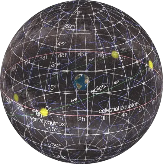

The direction of solar motion is referred to as the solar apex. It is at around RA=18h28m and Dec=+30d in the constellation of Hercules (you can see a map on the page linked to). Note that this is the direction in which you would see the "star wars" effect of onrushing stars diverging from the apex point. i.e. It demonstrates the sun's motion with respect to the local stellar population.
On your 2-dimensional cartoon of the Earth's, the circle is the ecliptic plane and the Earth's northern hemisphere (at winter solstice) is tilted away from the Sun at an angle of 23 degrees. The celestial coordinate system defined above is geocentric and the Sun is at 18h -23d at the winter solstice. The apex point is therefore towards the Sun but 57 degrees above it.
Look at the map below (produced by Christian Ready), you can judge where the solar apex is with respect to the Sun and ecliptic plane (green line), which is roughly the path (drawn in your diagram) that the Earth takes around the Sun.
Celestial sphere
The very bright star Vega is reasonably close to the solar apex direction.

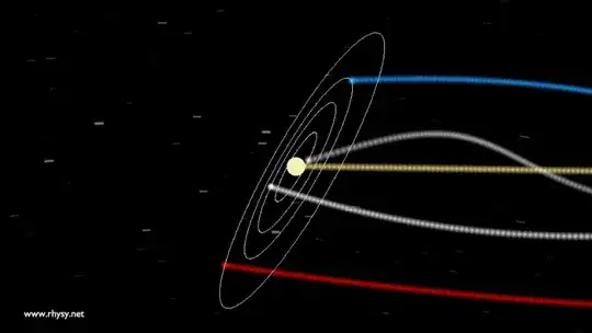

Relative to your drawing, the sun is moving south-ish:
solar system moving through space
The solar system is tilted about 60 degrees of the milky way plane, on which it's moving around like everyone else.

    the animation is a bit confusing. after rob jeffries answer i thought Sol was travelling 60deg off from earths north pole, the animation seems to show the opposite?
    by closest star I meant, if you had a laser pointer aimed at the direction of travel, which star or stars would be visually closest to the beam. it seems vega is a good answer for me.
    – Alonda Nov 30 '18 at 23:45
  • My understanding is that the solar system is tilted 60 degrees from the milky way plane. I'm not sure relative to earth's north pole, since earth is also tilted itself relative to the solar system plane. But the animation doesn't show in which way earth is tilted either, so you can't say the animation is following or not the tilt relative to earth's north pole. ;) – msb Nov 30 '18 at 23:56
    I assume the planets orbit the sun counterclockwise... that would make the sun in the animation move in the direction of its south pole. unless my brain malfunctioned. – Alonda Dec 01 '18 at 00:44
  • Oh! That's a good point. Not what I understood from your first comment, but I see what you mean now. Either the sun is travelling south, or the animation is wrong, then either the plane is tilted 60 degrees to the wrong side or the planets are rotating to the wrong side. Good catch! I'm at work now, I'll do a better research later and answer this properly. I'm quite curious about it too. :D Rob Jeffries's answer is very informative, but not straight to the point relative to your questions, hopefully I'll get the straight answers we want. ;) – msb Dec 01 '18 at 00:49
