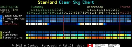

Seeing is basically weather-related, so it can be predicted to some extent. Go on the Clear Dark Sky website, search for a location close to your home, and pull up the chart:
http://www.cleardarksky.com/csk/
Look at the row called Seeing. If it's dark blue for the time when you plan your observation, chances are good that seeing will not get in the way. If it's light blue or white, the forecast is not good.
