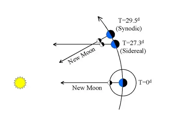

I should add that the most obvious opposition is the Full Moon, the synodic period of which is 29.5 days (i.e. from one Full Moon to the next), as opposed to the sidereal period of 27.3 days (i.e. how long it takes for the Moon to return to the same position relative to the background stars).
This image shows how it works with the New Moon, but the principle is the same: enter image description here Source (and explanation)
