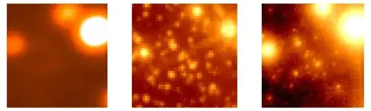

The OP wants to argue with me about whether the atmosphere is a significant factor. Of course the atmosphere degrades stellar images (it's not diffraction, but refraction). Going into space overcomes this and in the past this would have been the limiting issue. However, now it is commonplace for ground-based telescopes to achieve close to their diffraction-limited performance using adaptive optics techniques or "Lucky Imaging", both of which can and have got better images than the Hubble Space Telescope (examples below).
Example 1: The middle picture is from HST, the right hand image is Lucky Imaging from the ground based Palomar 5m telescope. The larger aperture of the Palomar produces better resolution despite looking through the atmosphere. See https://www.ast.cam.ac.uk/research/lucky for further details.
HST Vs Lucky Imaging

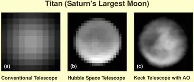

Example 2: HST image of Titan vs an image taken using adaptive optics with the 10m ground-based Keck telescope. Larger aperture wins again because the effects of the atmosphere can be avoided.
HST Vs Keck
