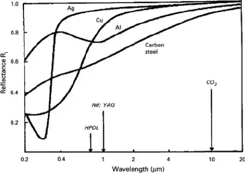

An image published (by the author) at Researchgate

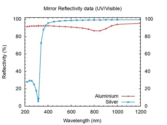

  • @astrosnapper added graph and tabular data – Carl Witthoft Oct 19 '18 at 12:18

I came across an article in the NOAO 2018 October Newsletter which discussed recoating of the 4-meter Blanco primary in Chile. This contained before, after and theoretical reflectivity data. I contacted one of the authors of the article for the source of the theoretical data who sent me a scan of the pages from R. N. Wilson's "Reflecting Telescope Optics II", page 426. I transcribed the data from the table for Alumin(i)um (Al) and Silver (Ag) and below is a plot of the Al and Ag data in the visible range:
Reflectivity of Aluminum (Al) and Silver (Ag) mirrors
(I've made more plots and the data files available in a post on my blog)
