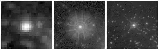

above: "Due to an oversight during fabrication, the concave shape of Hubble's primary mirror was too shallow toward its outer edges by 2 microns, a tiny fraction of the width of a human hair. As a result, starlight was not brought to a focus at the same point, resulting in blurry images. These three images show the same star as viewed from a ground-based telescope, left, and from Hubble's uncorrected mirror, center. The corrected image, after a space shuttle repair mission in 1993, is seen on the right" from here. credit: NASA

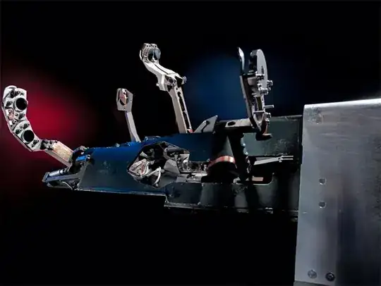

Question: Where exactly is the modification that first corrected the spherical aberration in Hubble's primary mirror? Can it be identified within the image below, or is it located elsewhere? Was the modification only a change in the figure of one of the small mirrors, or were other optical elements modified as well as part of the correction?
above: "The business end of COSTAR: Small mirrors on motorized arms directed corrected light into the Hubble Space Telescope's spectrographs and faint object camera. COSTAR and the Wide Field Planetary Camera 2 were installed during a 1993 shuttle mission, correcting Hubble's flawed vision." From here. Eric Long/Smithsonian Institution

The image provided is of COSTAR which replaced the High Speed Photometer and fed corrected light to the Faint Object Camera (FOC), Faint Object Spectrograph (FOS) and the Goddard High Resolution Spectrograph (GHRS). Since the WFPC2 was already going to replace WFPC1, the correction for the primary mirror's spherical aberration could be designed in (as it has been for all subsequent instruments).

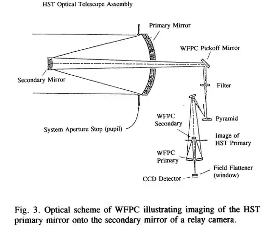

The overall layout of the HST optics (the Optical Tube Assembly (OTA)) and the WFPC camera optics is shown below in a figure taken from the Rodgers and Vaughan 1993 SPIE paper:
Light enters from the top left and is focused as normal by the HST primary and secondary mirrors and then part of the beam is picked-off into the WFPC2 camera.

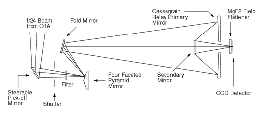

The WFPC2 optical configuration is shown in more detail below (taken from the instrument description section of the WFPC2 Instrument Handbook) WFPC2 optical configuration. The text just above that states:
The aberrated HST wavefront is corrected by introducing an equal but opposite error in each of the four Cassegrain relays. An image of the HST primary mirror is formed on the secondary mirrors in the Cassegrain relays. (The fold mirror in the PC channel has a small curvature to ensure this.) The spherical aberration from the telescope's primary mirror is corrected on these secondary mirrors, which are extremely aspheric.
indicating that the correction for HST's primary is done on the part labeled 'Secondary Mirror' in the diagram. Note that is the secondary mirror of the mini-Cassegrain telescope that is inside each of the 3 widefield and 1 planetary camera channels inside WFPC2 itself and not the main telescope secondary mirror which is off the diagram and part of the 'OTA' (Optical Telescope Assembly)

  • Thanks, but I'm hoping for an answer that addresses "Where exactly is the modification that first corrected the spherical aberration in Hubble's primary mirror? Can it be identified within the image below, or is it located elsewhere? Was the modification only a change in the figure of one of the small mirrors, or were other optical elements modified as well as part of the correction? – uhoh Oct 07 '18 at 06:21
    The simple answer is that the correction described in the quoted text -- modifying a mirror inside WFPC2 -- is not visible in "the image below", because that's an image of a different device (COSTAR). – Peter Erwin Oct 09 '18 at 13:32
  • I've added a diagram of the optical layout of WFPC2, indicating where the correction happens – astrosnapper Oct 09 '18 at 16:42
  • For some reason I'd missed your last comment and the edit, thanks! – uhoh Oct 29 '18 at 16:30
  • okay I think that I finally understand this diagram! The f/24 beam at top left is from the telescope's secondary mirror. The "Cassegrain" primary and secondary shown in the diagram are not the telescope, but instead an optical relay camera, which "demagnifies" the the image to better match the CCD's format. Better late then never! I am surprised that the first focus appears to be on the surface of the four-faceted mirror. Usually one tries not to have real images at physical surfaces (unless they are film or sensors) to avoid defects or dust becoming part of the image. – uhoh Jan 22 '19 at 23:00
The small mirror inside WFPC2 which provided the correction for that instrument is not visible in that photograph, for the simple reason that the photograph shows COSTAR, a difference device.
For what it's worth, three of the four projecting arms in that picture carry the corrective mirrors that COSTAR used to fix the optical input to the Faint Object Camera, the Goddard High Resolution Spectrograph, and the Faint Object Spectrograph. You can see that the far-left and the second-from-right arms have two mirrors each (the small, dark, circular objects), which means they provide correction for the FOS and the FOC (I think the FOS corrector is the second-from-right arm); both of these instruments have two modes, requiring separate correction mirrors for each mode. One of the other arms has the correction mirror for GHRS. (I'll admit I don't know why there are four arms.)

The image you have is of COSTAR. The modification to Hubble was to actually remove another instrument and place COSTAR inside. Once inside, it deployed and the other instruments were corrected. So the entire thing in the image is the modification.
Over time, new instruments were built and installed in Hubble. Those instruments (like WFPC2) were built to have the correction inside the instrument. When all of the original cameras were replaced, COSTAR was no longer needed and was also removed.

    That's not correct. COSTAR corrected the image for Faint Object Camera (FOC), Faint Object Spectrograph (FOS) and the Goddard High Resolution Spectrograph (GHRS). by placing new elements in their optical paths. In later missions, most of those instruments would be replaced with new instruments that had corrections built in, making COSTAR redundant over time. – Hobbes Jan 23 '19 at 10:27

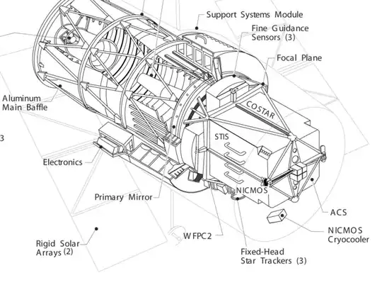

The HST has space for 4 main instruments. Each of them consists of a box with electronics, with a CCD or other detector on one end, in the focal plane of the telescope. The fifth instrument, WFPC is placed radially in front of the focal plane.
This image is from later in Hubble's career. FOS, FOC and GHRS (see below) have been replaced by STIS, NICMOS and ACS. The principle remains the same.
During Servicing Mission 1, 2 major changes were made:
  1. the WFPC was replaced with WFPC2. WFPC had correctional optics built in, as described in astrosnapper's answer.
  2. the High Speed Photometer (HSP) was removed and COSTAR installed in its place. COSTAR did not have a CCD. In its place was a structure containing a series of mirrors, this structure protruded into the optics space in front of the focal plane.

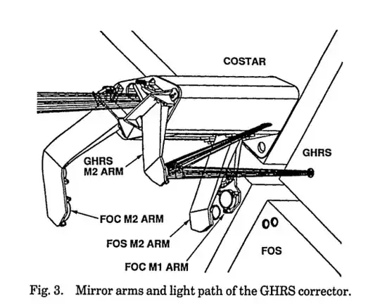

    This diagram shows the COSTAR mirrors in place:
After installation, small arms with one mirror each unfolded from the structure and into the optics paths for the Faint Object Camera (FOC), the Faint Object Spectrograph (FOS) and the Goddard High Resolution Spectrograph (GHRS). There were two mirrors per instrument. These mirrors corrected the image.

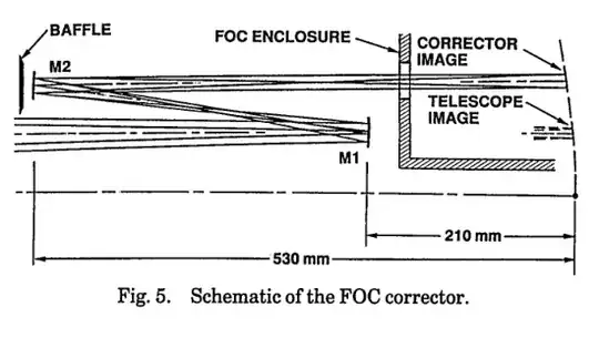

Here's the optical path for the FOC:
In COSTAR each corrector consists of a spherical field mirror Ml and an aspherical reimaging mirror M2 (Fig. 1). The function of Ml is to image the telescope primary mirror at M2. A spherical mirror suffices.
M2 is a fourth-order anamorphic asphere. The fourth-order term compensates for the spherical aberration and must be slightly anamorphic because the corrector mirrors do not form a centered system. Control of astigmatism requires M2 to be anamorphic of the second order also.
In total five sets of correctors are required. They serve the two cameras in the FOC (f/48 and f/96 cameras), the short-wavelength spectrograph in the FOS (FOS blue), the long-wavelength spectrograph in the FOS (FOS red), and the GHRS.
