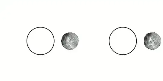

Here is a gif showing tidal locking. The tidal locked moon is on the left.
Now imagine you are back on Earth. Throughout the course of the day you can see the Moon move across the sky. That's because 24 hours is drastically shorter than 29.5 days. However, if you were standing on the Moon, the Earth would appear to stand still. Now, it would actually appear to wobble a bit because of the Moon's orbit's eccentricity, but it more or less stays in the same place.

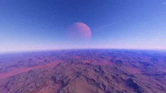

Here is an artistic yet scientifically accurate rendition of what it would look like. It's from Space Engine. Notice how the gas giant (the planet) wobbles a bit but stays in roughly the same place. It would look similar if you were on the Moon, but without the atmosphere, and the Earth would obviously be smaller and further away.

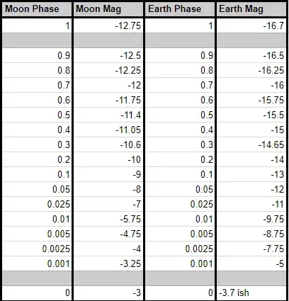

At full moon, the Moon has an apparent magnitude of roughly -12.75. At full earth, the Earth has an apparent magnitude of -16.75. That's about 40x brighter! If we were to qualify phases as a % from 0% being a new moon to 100% being a full moon, then every 10% you go below 100%, the apparent magnitude of each phase decreases by about the same amount. For example: 90% Earth would be roughly -16.5 (+.25 magnitude), and 90% Moon would be roughly 15.5 (also +.25 magnitude). The differences in magnitude only get larger when you go below 10% phase, where each little bit of the celestial body that shows adds a lot more to the magnitude.
Here is a rough chart:
