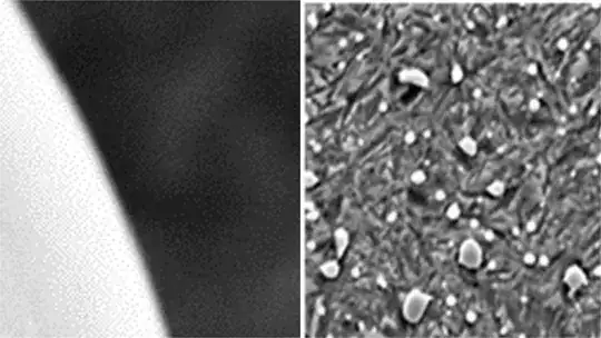

When you look at a spherical object from a distance it appears round, sometimes when you view it from close up it doesn't appear quite so smooth (or round). The wavelength that you look at an object with also affects what you are able to see.
High resolution SEM image of CN ball bearing $$\scriptsize \text{Figure 6. High resolution SEM image of CN ball bearing inner ring fabricated from 52100 steel showing} \\ \scriptsize \text{fine globular cementite. Presence of fine precipitates of carbides and nitrides uniformly aggregated in the} \\ \scriptsize \text{fine martensitic microstructure, which act as obstacles to the motion of dislocations.}$$
The above scanning electron microscope image of a smoothly ground ball bearing illustrates this, from a relatively far distance it appears smooth; from much closer the particles constituting its makeup become visible. Image Source: "Effect of Carbonitriding on Endurance Life of Ball Bearing Produced from SAE 52100 Bearing Steels", by Karthikeyan Rajan, Vinod Joshi, and Arindam Ghosh.
