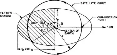

I found a convenient formula to determine Eclipse (satellite in shadow). From Ismail, et al., Equation 10 here.
Image from same article:
Theta-E is the angle of eclipse
So time in shadow = ((Theta-E)/360)*Orbital Period.
But how do you calculate Theta-E? Well, for my part, I used the law of similar triangles. You will have two similar isosceles triangles - one from the Earth to the point of the umbra cone and one from the Sun to the point of the umbra cone. Cut the isosceles triangles in half and use the right triangles. The sides of similar triangles are proportional and using the distance of 1 AU and the radii of the Sun and Earth, you can find the distance to the point of the umbra cone with a little algebra. Then use the arc-tangent to find the half-angle to the distance at GEO, then doubled it to find Theta-E.
You should be aware, however, that you are dealing with (1) circular orbits with (2) 0 inclination. The time of year also can change things.
My result was very close to that of James K. with only a few seconds difference.
