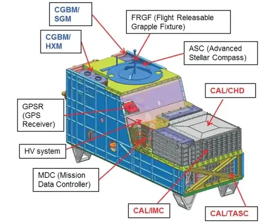

See Wikipedia's page: "Calorimetric Electron Telescope":
The CALorimetric Electron Telescope (CALET) is a space telescope being mainly used to perform high precision observations of electrons and gamma rays. It tracks the trajectory of electrons, protons, nuclei, and gamma rays and measures their direction, charge and energy, which may help understand the nature of dark matter or nearby sources of high-energy particle acceleration.
For more information see: "The CALorimetric Electron Telescope (CALET) for high-energy astroparticle physics on the International Space Station" (O Adriani et al 2015 J. Phys.: Conf. Ser. 632 012023):
Figure 1
Figure 1. Drawing of the CALET payload. On the ISS the payload will be installed in such a way to have open sky on top, Earth on bottom.

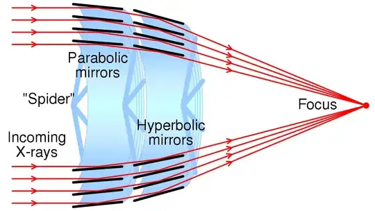

And the answer to that is probably not, and the reason is interesting! Using
$$E = \frac{hc}{\lambda}$$
and $hc = 1.24$ eV microns, we see that if an atom is 2.5 Angstroms and that's a quarter wavelength, the wavelength is 10 Angstrom or 0.001 micron. We're now talking about a photon energy of 1240 eV or 1.24 keV.
At that energy single atoms are mostly transparent. Here's a plot from https://henke.lbl.gov/optical_constants/atten2.html for the X-ray attenuation length in aluminum. It's of order of microns!
X-ray attenuation in Aluminum, 1 to 2 keV
In other words, by the time that individual atoms become comparable to wavelength, they also become mostly transparent and it's really the bulk properties like crystal diffraction and/or tiny variations in index of refraction.
So instead what's used for imaging X-rays in space telescopes (X-rays don't make it to the ground) is grazing incidence off of very specially manufactured surfaces. They are alternating layers of two materials with different index of refraction for X-rays. The difference is tiny and so the number of layers is large. The x-rays pass through many layers and sample the periodicity and depth of these material property variations. Single atoms out of place or atomic roughness of the layers might have a weak, second order effect, producing a bit of haze around very bright point sources, but they won't affect wavefront error.
X-ray telescope
