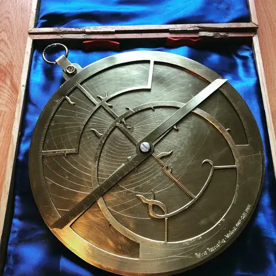

(Oddly enough, a simple instrument, invented by the Greeks almost 2,000 years ago and perfected by the Muslims over the next few centuries, the astrolabe, would give you the answer almost instantly, without having to do any calculations. Below is a photo of one I made in brass.)
Brass astrolabe, home-made by Pierre Paquette, 2020
