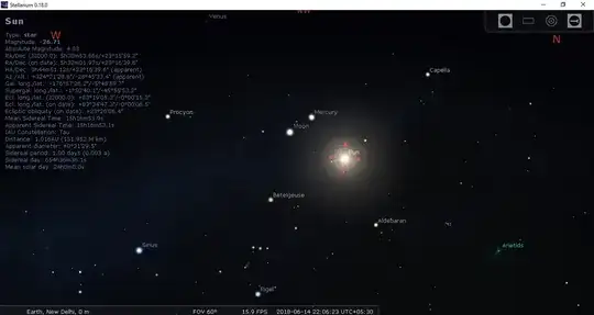

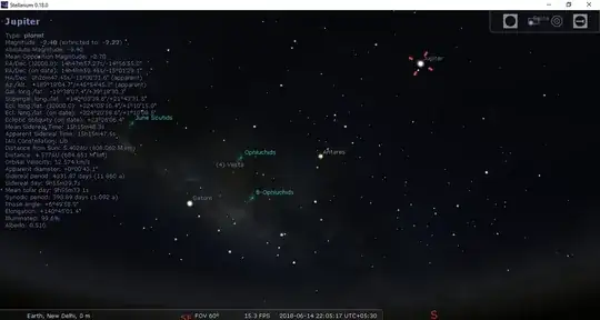

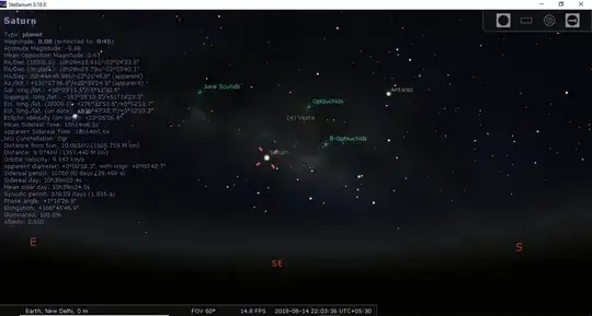

I use Stellarium software to find positions of planets. Here I am adding positions of Saturn, Jupiter and Sun.
Stellarium shows information about selected objects, can it be used to calculate angle formed, for example, angle formed between Saturn and Jupiter taking Sun as reference point?

  • I use Stellarium software, I've updated the question with screenshots taken from it, please take a look. – Chinmay Sarupria Jun 14 '18 at 16:48
  • This answer is exactly correct: if you know the position of two objects on the unit sphere, you can use spherical geometry to compute the angle between them as above. –  Jun 14 '18 at 16:52
  • To calculate the angle between two objects as seen from the Sun, you need those positions as seen from the Sun. The positions given in the images you added to the question are positions as seen from the Earth. If you can change Stellarium to show the "sky" as seen from the Sun, you should be able to get the heliocentric ecliptic latitude and longitude (or find these values from JPL's Horizon). Then replace RA in Jame's formula with longitude and Dec with latitude and the calculation will give you the angle between the objects as seen from the Sun. – JohnHoltz Jun 14 '18 at 16:58
  • @JohnHoltz Thanks, just to understand the calculator, I would like to use the current values in the question which are relative to Earth. In Saturn screenshot above, you can see there are 2 Ecliptic latitude and longitude per selected object, which one to use? Also James gave a calculator link, that calculator says enter RA and Dec in decimal hours but the latitude and longitude available are in degree form, what to enter? I would be grateful if you could help me a bit with the calculator. – Chinmay Sarupria Jun 14 '18 at 17:44
  • @JohnHoltz I was able to figure out the values required in the calculator. It requires J2000 RA and Dec values not Ecl. Longtiude and Latitude. – Chinmay Sarupria Jun 15 '18 at 03:52
