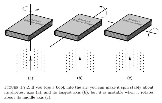

An object that is not subject to any external torques will have a constant angular momentum. This does not mean that such an object will have a constant angular velocity. Place a rubber band about a book and toss it in the air, giving it a nice spin rate before letting it go.
Canonical experiment regarding stability of rotations using a book on classical mechanics
See the question Stability of rotation of a rectangular prism for details.
Hyperion is small enough and rigid enough that it's not quite capable of pulling itself into a roundish shape by its self gravitation. It instead has a markedly triaxial shape. Designating the principal moments of inertia as $A < B < C$ (corresponding respectively to the rotations in subfigures b, c, and a in the above image), the longitudinal libration parameter $(B-A)/C$ is about 0.21 for Hyperion. That's huge, and is a key factor that makes Hyperion's rotation chaotic. If Hyperion was a perfectly rigid body that wasn't subject to external torques and was instantaneous rotating about an axis close to that depicted as c in the above figure, it's rotation would essentially be chaotic.
