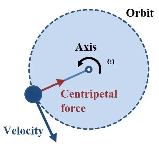

By the way, in Physics there is no centrifugal force -- this is actually a misconception many people have. However, there is centripetal force.

    Obligatory rebuttal-via-xkcd link: http://xkcd.com/123/ – Ilmari Karonen May 24 '14 at 21:41
    @IlmariKaronen Thanks for the down-vote, however, you do realize that the cartoon doesn't prove anything right? There is a difference between Centripetal force and centrifugal. – apxcode May 24 '14 at 22:01
    To be fair, the cartoon points out that centrifugal force is as inertial force, which is true. Arguably it's sensible to interpret inertial forces as "not real", but I'm not sure what bearing that has on this question, since gravitational force is an inertial force as well. – Stan Liou May 26 '14 at 03:54
  • This "answer" is pretty vague, makes questionable statements, and has no real bearing on the original query. – Florin Andrei Jun 03 '15 at 19:48
