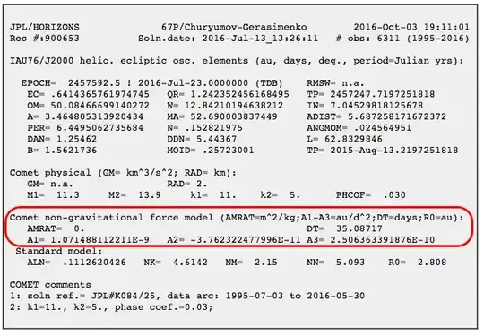

In this answer I plot some data from a recent NASA JPL Horizons ephemeris for comet 67P. The current default solution soln ref.= JPL#K084/25, data arc: 1995-07-03 to 2016-05-30 appears to use Marsden coefficients to model non-gravitational forces on the comet. Brian . Marsden was a British astronomer who contributed greatly to the field of cometary orbits. (See also here and here.) While exact modeling of non-gravitational forces on comets would be extremely complex, he introduced a simple empirical parameterization that provides a framework to discuss the magnitude and potential effects of these forces on the orbits of comets.

above: Example of the non-gravitational parameters used in the most recent JPL Horizons ephemeris for comet 67P. The coefficients have units of $AU/day^2$. For a comparison, the gravitational acceleration at a distance of 1.2 $AU$ is about 0.0041 $m/s^2$ or about 2.1E-04 $AU/day^2$. This suggests that the non-gravitational forces used here have a parts-per-million effect per orbit which will become substantial over a large number of orbits.
